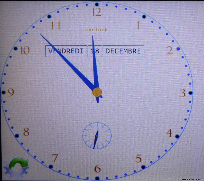

Hi
This video shows the interest of using the "intelligent" Nextion .
the gauges have the possibility to be transparent, i.e. the hand is displayed but not the background.
This considerably reduces the number of programme lines.
Moreover I used the internal RTC which frees an I2C port.
Again this is possible only with the "intelligente Nextion display
[img][/img]
Video here : https://youtu.be/rZ9rJepxNWU
code here :
JP Wink
