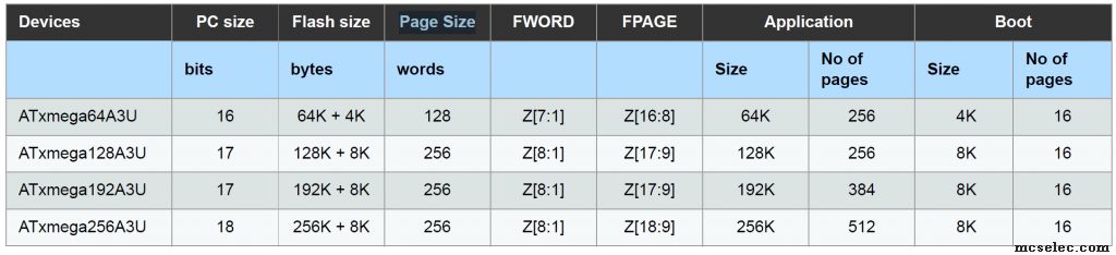

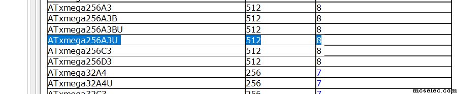

Acording to BASCOM HELP the page size should be 512 Words and therefore Maxwordbit=8
According to Xmega256A3U datasheet the page size should be 256 Words and therefore Maxwordbit=7

the location is Z1:Z8 thus a value of 8 is correct
