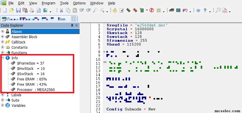

Some advice about free SRAM you will find in the CodeExplorer - just enable it.

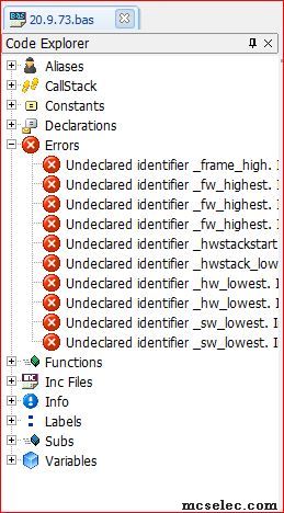

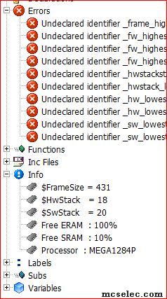

These numbers are much more believable but there are now errors in code explorer saying that all the _frame & stack variable are undeclared.

My pedigree does not include reindeer, nor am I called Rudolf.
...that all the _frame & stack variable are undeclared.
If they would actually be undeclared, your code would not run and use them.
It's some issue with the code explorer, which does parsing and checking independently from the compiler.

My sincere apologies mws - for some reason I thought that was your name. I wasn't being cheeky or flippant.
Yes obviously these var must be declared in the .lib. Anyway - the values seem reasonable, but they are considerably different from the info values.
I would rather verify the values from stackcheck against the declared values for stack/frame, additionally I'd have a look what the report says.
About the code explorer's info: everything therein can be only info which the compiler provides at end of compilation, thus it's static info.
I do not know how these values are derived in detail, but for example the compiler can count local variables going to frame, or it can assume if there's a print instruction, then it needs a minimum of swstack, but the compiler can not guess from a statical picture, how it works dynamically.
That's what stackcheck does, it does a check under (nearly) real conditions. With the disadvantage of 'nearly', which means that in case your code works a week and does not call all the week a special memory-hungry function, you still do not know what happens in one week and one second.
If in contrary you are sure that within this week every function, or chain of function calls and every combination thereof was executed one time and no memory leaks exist, then stackcheck gives you the correct representation of memory usage.
This is obvious, and therein lies the rub - statics test vs dynamic.
I was hoping the little test routine shown in the help would give sensible results, but it appears not - I should re-phrase that - I haven't been able to get sensible numbers.

So the Code Explorer returns the deepest nesting space estimate. But not taking into account(yet) the space required by the asm libs. these do not take much in general. so personally i add 40 to hw stack.
Code like this :
dim s as string * 100
s="test"
s="abc"+ s
requires a temp copy. the Code Explorer does not take this into account.
