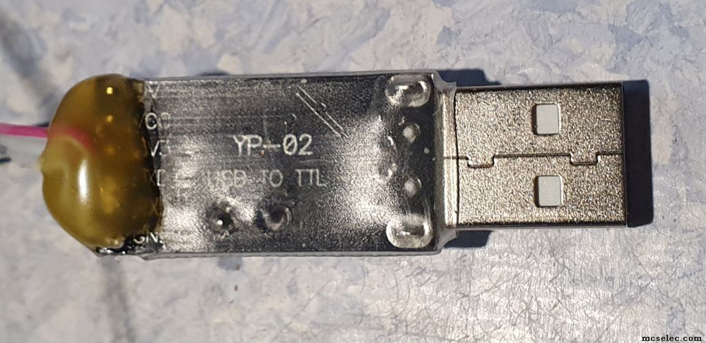

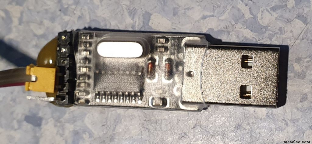

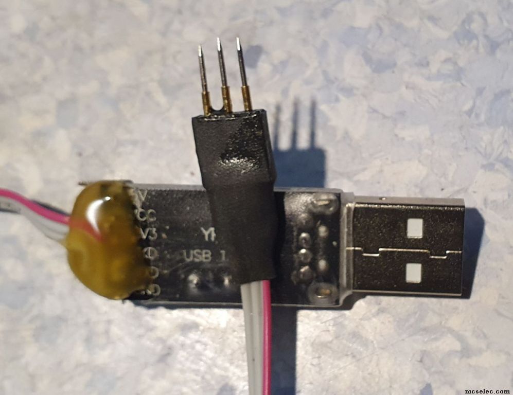

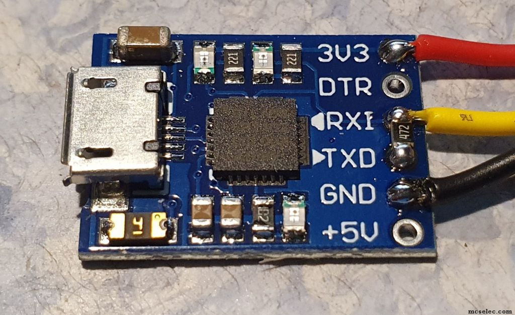

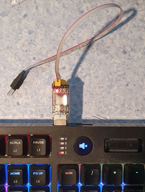

PostPosted: Wed Apr 27, 2022 11:43 pm    Post subject: Simple UPDI programmer Reply with quote
Hello guys. I just recently started with Xtiny family. Both CH340G and CP2102 work well for me. (Bascom AVR 2.0.8.5, WIN10 with all updates). Tested on Tiny3216 and Tiny804) Others I didn't test. Maybe this will help some beginner to bootstart his project.
If you really need a quick and dirt cheap UPDI programmer, you can use the USB to RS232 TTL adapter from our popular vendors. CH340G is the cheapest, about 1€ with shipping. Since it already has a 1k5 resistor you can simply connect RX and TX together and you get UPDI. On CP2102 I added the 4k7 resistor and that's it. The only real downside of this programmer is it's speed. It is very slow, 8kB of code is loading ~20 seconds.

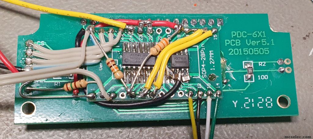

I'm planning to upgrade it to 12V HV-UPDI so I could use the pin for other purposes. If DTR could be used to trigger 12V pulse it would be great. I didn't check, if this is implemented yet (hint to Mark😉). I added some pics for reference, together with my dirty weighing scale prototype. I hope it heps somebody. All the best from me.
PostPosted: Thu Apr 28, 2022 2:12 pm    Post subject: Reply with quote
Thanks for the info. All info helps, especial with pictures.
