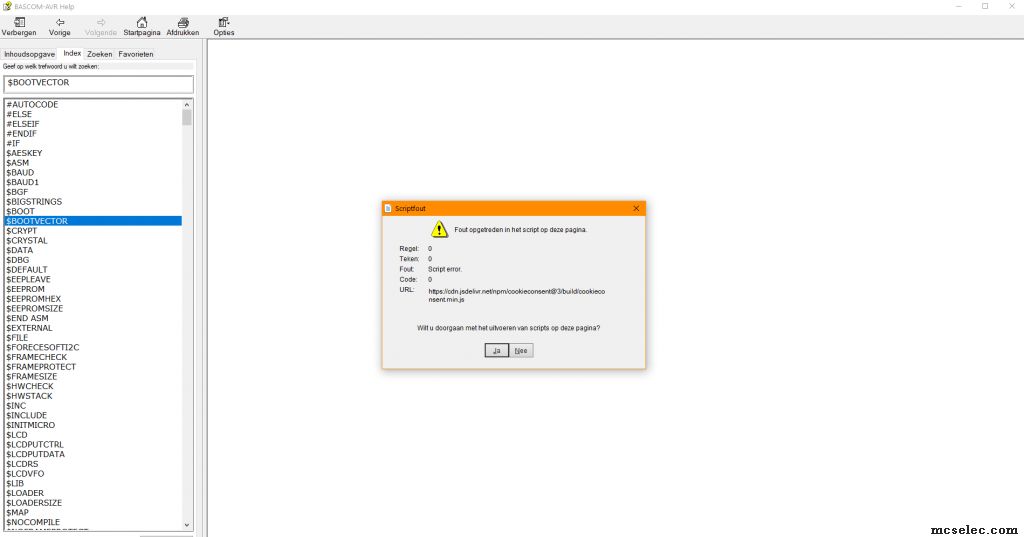

Edit: I discovered that pressing "Startpagina" in Help opened an error warning. If I choose to continue ("Ja")...
...then I see this:
PostPosted: Thu Aug 27, 2020 9:42 am    Post subject: Reply with quote
the start page points to the MCS web start page. the pop up is for the web access permission. when you use the browser you also have to give consent that the site uses cookies.
so when html help loads the browser it also requires this.
when you remove the bascavr.chw file, and then run the chm file again, it should show content.

also, with explorer, right click the help file and chose properties.
Then click the UNBLOCK check box in the general tab page.
Dont know why it would block when previous version worked but this is a common problem with windows chm help.

PostPosted: Thu Aug 27, 2020 10:20 pm    Post subject: Reply with quote
That worked! I have to unblock because "it comes from an other computer" (the MCS computer?).
