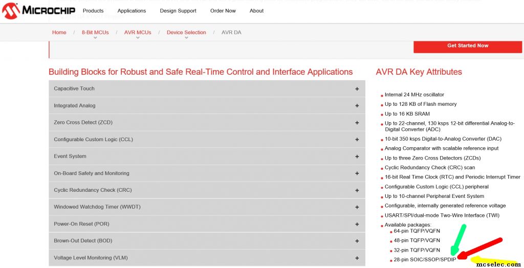

PostPosted: Fri Jul 10, 2020 2:34 pm    Post subject: Reply with quote
it depends on how much interest there is in the xtiny add on.
and of course in this new series.
i did not see PDIP but maybe i overlooked something.
The problem with xtiny was that i started with preliminary docs which changed a couple of times. some casings were removed.
edit : oeps, overlooked it.

PostPosted: Fri Jul 10, 2020 2:39 pm    Post subject: Reply with quote
Hi Mark,
I believe the PDIP version exists, which I think has usually been of interest to Bascom.
Check you Support eMail, I sent you an eMail a while back offering to send you a few AVR128DA48's to work with, if you so desire.
Take care,
JC
