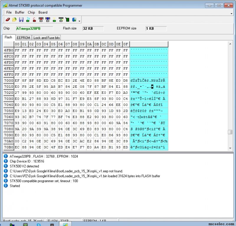

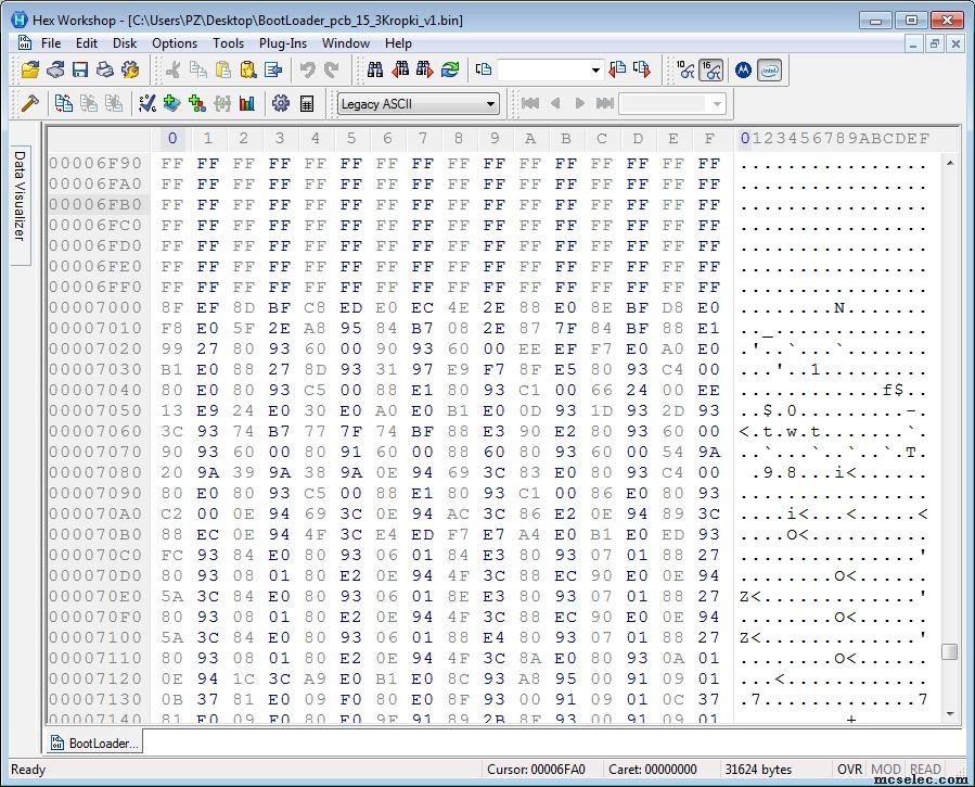

I wanted to cut off FF data at the begening of my bootloader bin file.
And here I found the first problem.
I programmed ATMEGA328PB with my bootloder alone to be sure that everything is ok. Bootloader works well.
Then I read the ATMEGA328PB flash buffer by STK500 programmer (memory lock fusebists are temporary unprogrammed).
The result you can see on picture1
Then I loaded my bootloader bin file into HexWorkshop. The result you can see on picture2.
The data starts at the same address, but looks direfently.
The question is why?

MSB/LSB of the data words are swapped, check your settings in Options->Compiler->Output.
Using the .hex files to create a combined image is a bit easier, since the addresses are also stored in the files: https://www.avrfreaks.net/forum/combining-hex-files
avr-objcopy is part of the avr-binutils: https://www.microchip.com/mplab/avr-support/avr-and-arm-toolchains-c-compilers and is also part of the Atmel Studio installation.

Thanks Netzman for the hex word swap explanation.
I prepared my bootloader mini version without FFs at the begining using HexWorksop
I compared this bin file with "normal" bootloader bin, its identical, but without these first FFs

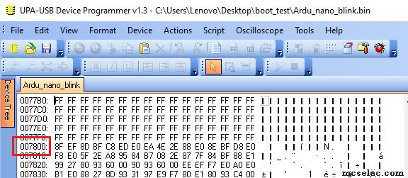

Posts: 1133
PostPosted: Wed Jun 24, 2020 8:04 pm    Post subject: Reply with quote
I`ve tested it today with Arduino Nano board and it works like it should.
On the begining of the flash I have Blink code and at address $3C00 x 2 = $7800 I have bootloader in the Bin file.
I even test this bootloader with some another time periods for blink and it works too Wink
