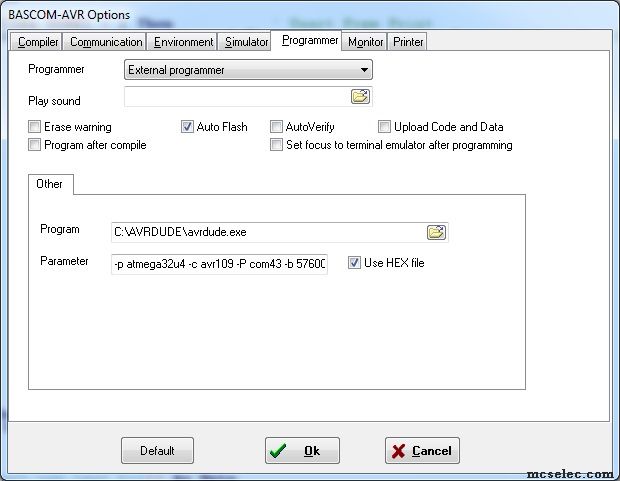

You should configure external programmer like this screen shows:
So you should have Avrdude too.
Once again parameters are : -p atmega32u4 -c avr109 -P com43 -b 57600 -V -D -U flash:w:"{FILE}":i |

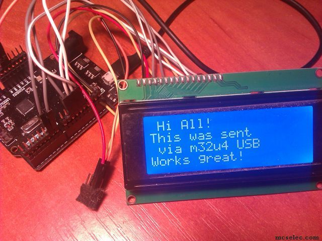

Cause m32u4 have bullit in support for USB that board dont have any USB to USART converter. Because of that this board should be cheaper...and Arduino IDE add support for this USB firmware to every sketch.
Because I have USB addon I also add support for USB to my programs for that board and look -> I send this message via USB straight from Bascom terminal to this LCD -> it works
Simply in Bascom you have more control and must/or not add support for USB.
