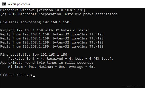

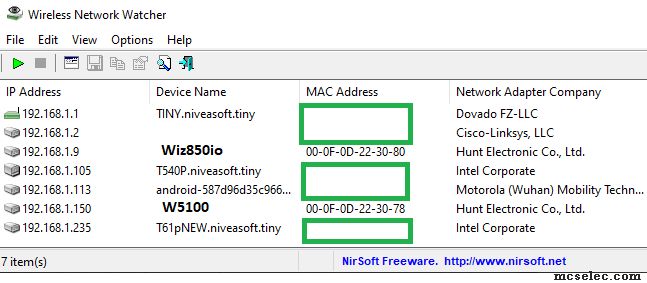

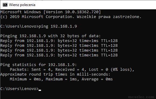

I can tell that there is no problem for me to ping in my home network my two currently online devices like W5100 and Wiz850io.
Look at the screens. They both appear in the WNetWatcher from Nirsoft and PING straight from Windows console so I think problem is not in the Wizznet registers Very Happy Even MAC can start with zeros Very Happy

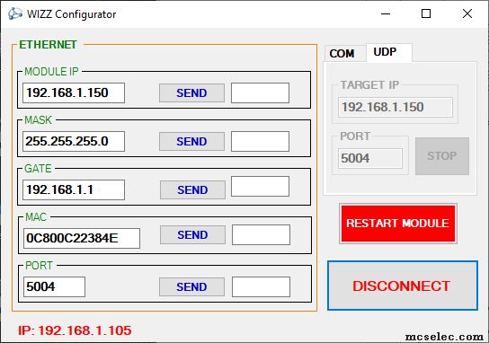

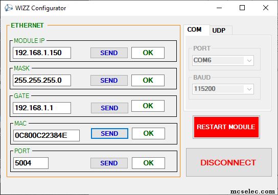

My Wizznets working with parameter "NOINIT" in the TCPIP CONFIG so I can compile one soft for all my devices like W5100 and after programming I set them (IP, GATE, MASK, PORT etc.) with my software and store config in the eeprom.
So at the end -> to the point.
Try use Noinit and then config Wizz with SETTCP
I think I will share my API for Bascom that work together with that PC software if I find some time...
