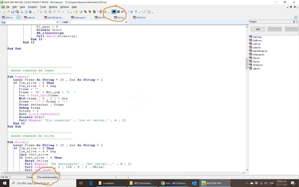

Hi everyone. I have seen that they are testing the beta beta of version 2.0.8.3. Please keep in mind that when the serial terminal is minimized it is impossible to restore it, at least for me in W10. I close Bascom, reset the computer and nothing, until at some point it runs again.

Hi, thanks for the quick reply. Indeed when I rename bascom-avr2082.xml the problem is solved by creating the default xml, but I also lose all the system configuration,
Look in the XML and I found the problem, in the xml version that doesn't work you see the following:
<frmTerminal>
<ShowCmd> 2 </ShowCmd>
where the value works is 1:
<frmTerminal>
<ShowCmd> 1 </ShowCmd>
I send you a photo of what is happening.
I tell you that the same thing happened to me with version 2.0.8.1.
Best regards.
[img][/img]

PostPosted: Mon Mar 30, 2020 7:39 pm    Post subject: Reply with quote
Hi Mark, thanks for your reply.
I use Windows 10 Pro, 64 bit, Version 1903 of 2019, I also did it before the last update.
The problem is that the minized window that you show me does not appear to me.
Greetings.
sielcon
Joined: 16 Mar 2006
Posts: 82
Location: Argentina
PostPosted: Mon Mar 30, 2020 7:46 pm    Post subject: Reply with quote
I found the problem, the taskbar was locked and it did not show that the terminal was minimized.
Thanks for everything.
