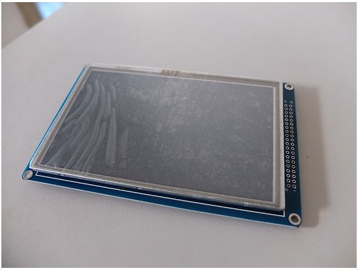

This is the display

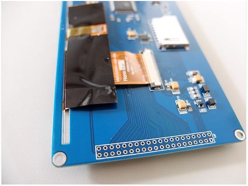

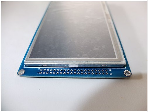

The back with the 40 pin connector
40 pins to fit the shield

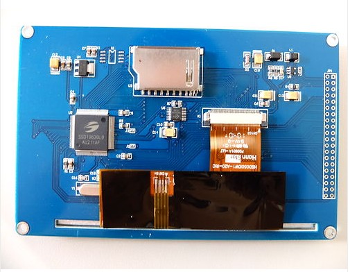

The back of the display

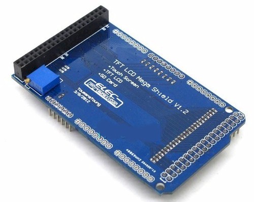

This is the shield for the Arduino Mega

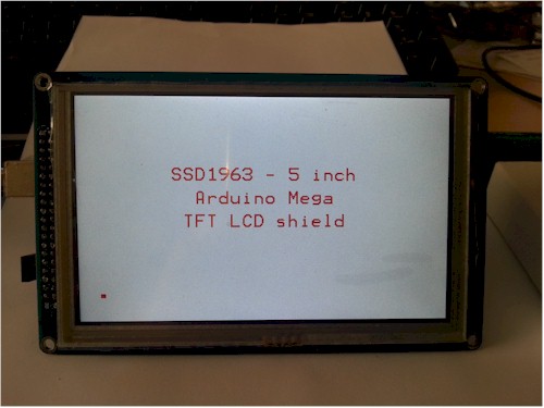

This is when you run the Bascom-AVR code in the attachment
You should see a small box on the left go up, reverse the screen and after that showing the text.
