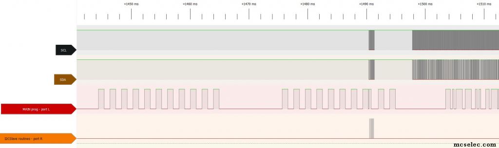

When zooming into this I found someting remarkable (at least to me): when there's I2C trafic, either adressed to slave or to other devices, the main program seems to get impacted.
See screenshot attached. A simple on/ off setting of ports with 'waitms' in between becomes messy when in parallel there's I2C trafic. Since the I2C has prio via interrupts, I would expect the wait time to increase, but certainly not decrease? Could this indicate some issues with how the registers are saved during the interrupts/ I2C handling or an issues with timer conflicts? And as such, could this cause also issues 'back to the I2C algorithmes' since in end they fail as well? (PS: I could not get clear which timer is used by the I2C slave routines, it doesn't matter if I use timer0 or timer1 for the main prog; both seem to 'work'?)

In screenshot of the logic analyzer you see instances of toggling the output ports. It's ok when no I2C traffic and gets corrupted when there's traffic.

so you are using the USI slave.
This does NOT use any timer or other interrupt, only the USI interrupt.
The downside is that this is some counter logic that keeps firing interrupts because there is not much intelligence in the hardware.
What i mean is that TWI once addressed, does not bother with other addressed slaves. it goes smooth from one state to the other.
But USI keeps on working and thus reacting on all the bus traffic.
like all interrupt code, code should be short and not take a long time to execute.
using i2c, there is not a real problem if the int. takes some more time but when other code is running, it depends on that code if you can delay it.
for this reason, the slave should just return data or receive data. this takes little time.
1wire is very time critical. so this should be executed without the slave interrupting the 1wire code.
you could disable interrupts when performing 1wire code.
the pushall/popall is already inside the USI SLAVE so there is no need for this.

Since the attiny85 has a USI interface, I assumed I needed to use the USI slave lib. Would the TWI lib work as well on this device?
Wrt disturbing the 1wire communication : this indeed happens but by checking the crc or just ignore when an interrupt has occured, I can deal with it. The other way around: to disable the interrupts will lead to disturb the I2C communication which is more complicated to handle/ recover.
Actually this was my original problem: somehow the I2C slave routines get disturbed when in parallel running the 1W in the main loop, where-as you would expect the oppposite (interrupt driven routines ok; main prog disturbed). So that's when I start debugging with the logic analyser with the results above.
And I still have no clue how in the fully stripped prog above (only some set ports high and low plus some waitms statements in the main loop) and just listening to the I2C traffic, the main prog can be impacted in such that the wait loops get incidentally shorter (!) ? Only thing I can imagine is that either the USI lib does not correctly save the registers by push/ pop and hence overrides the wait counters OR I don't understand how the wait loops work... ?
(maybe this is in the end not related to my initial issue, but it seems so basic that I first want to get this solved Wink)

since the processor you selected does not have TWI, you can not use the TWI slave.
the slave saves all used registers.
but as always with isr you need to take care that the main code and the ISR code are not working on the same variables.
what you describe seems more like a trashed register. regs used by the USI int are however saved especial the ones used by waitms.
a downside of USI is that it is very simple and interrupt fires for all data, even when not for the USI slave.
on the other hand i2c can work at low frequencies so while some code like 1wire can be goofed up, the master should not be affected.
you should reduce the code in your sample and also post the used master code.
