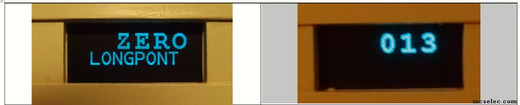

Posts: 1197
PostPosted: Thu Jan 02, 2020 10:21 am    Post subject: Reply with quote
this small prog work for me i add only the first lines
'-----------Microcontroleur------------------------------------------------------------------------------------------------
$regfile = "attiny85.dat"
$crystal = 1000000
$hwstack = 40
$swstack = 40
$framesize = 40
'---- config------------------------------------------------------------------------------------------------------------------
Config Clockdiv = 8
Config Submode = New
 '-------------------------------- I2C bus  Tiny85--------------------------------------------------------------------------
Config Sda = Portb.0
Config Scl = Portb.2
I2cinit
Waitms 5
' -------les ports------------------------------------------------------------------------------------------------------------
Vote Alias Portb.1
Raz Alias Portb.3
Config Vote = Input
Config Raz = Input
Set Vote                                                    'activation des pull up
Set Raz
 'display---------------------------------------------------------------------------------------------------------------------
$lib "glcdSSD1306-I2C.lib"
Config Graphlcd = Custom , Cols = 128 , Rows = 64 , Lcdname = "SSD1306"
Dim Lcd_auto As Byte
Lcd_auto = 1
Enable Interrupts
'----var-----------------------------------------------------------------------------------------------------------------------
Dim Compteur As Integer
Dim Regb As Byte
Dim Memoire As Eram Integer
Dim Fxmem As Integer
Dim Stcomp As String * 3
Dim Flagzero As Byte
'---prog----------------------------------------------------------------------------------------------------------------------
Compteur = 0
Fxmem = Memoire                                             'lecture mémoire
If Fxmem => 0 Then Compteur = Memoire
Setfont Font12x16
   Cls
   Lcdat 4 , 1 , " LONGPONT"
krolikbest
