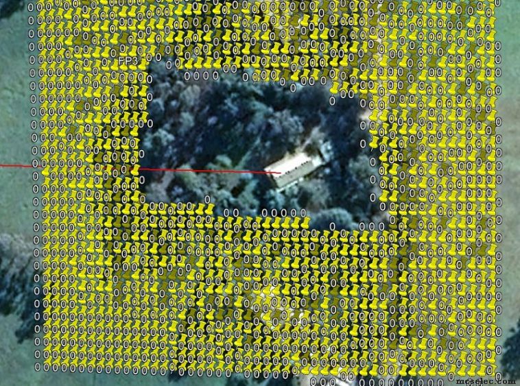

This is a work in progress, it works but the poly point array must start and end with the same coords.
I'm having a hard time getting this to happen in the next loop. ie closing the polygon
taken from one of the many pnp ray tracing algorithms on line
as it is now, its enough for what i need.
The test is just a static one - you'll need to capture the serial output and send it to a kml file
YAT (yet another terminal) works well for this

call PIPtestKML(0.0005,0.00005) generated the kml below
with the preload sub lat lon values - for an idea of resolution
