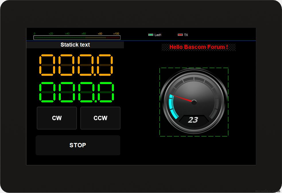

Can you send us a video or a image ?
what type of screen did you use?
how does 4D system communicate?
Serial, I2C, Spi ...?

I have the 7 inch with capacitive touch screen, the model is GEN4-70DCT-CLB.
You can get more details from the link below:
https://4dsystems.com.au/products/4d-intelligent-hmi-display-modules/sk-gen4-70dct-clb
Display communicates with the host over serial port.
But there is also 30Pin ZIF connector with number of pins available for the user.

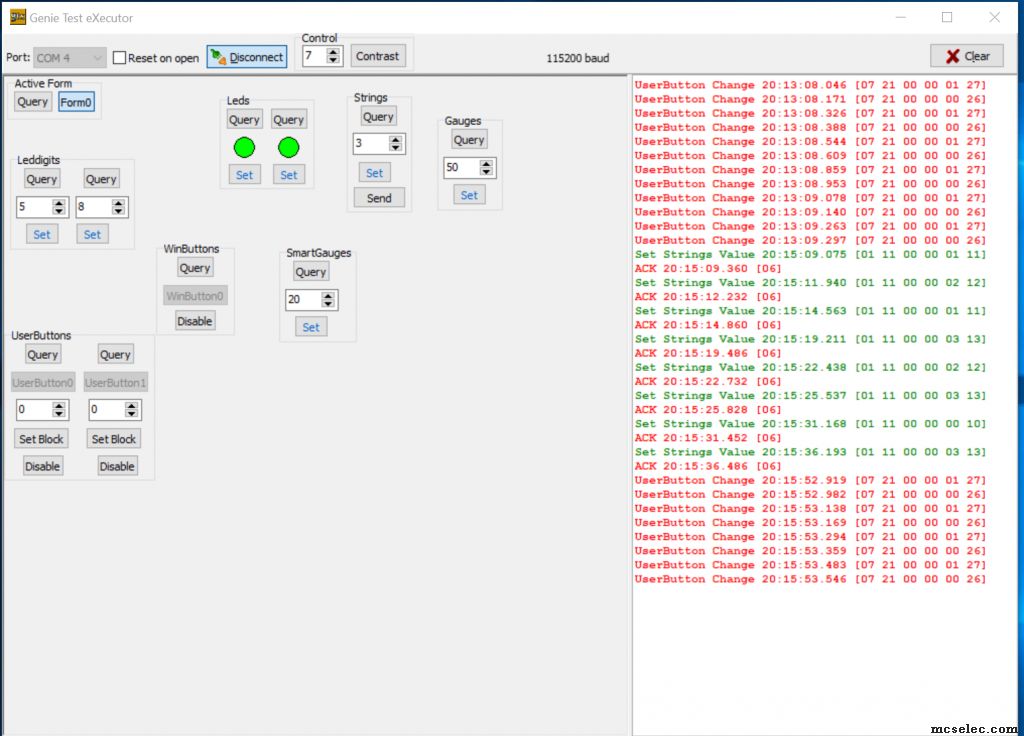

The most important part is the IDE which comes with four different environments.
https://4dsystems.com.au/workshop4
Designer:
This environment enables the user to write 4DGL code in its natural form to program the display module.[/i]
ViSi - Genie:
An advanced environment that does not require any 4DGL coding at all. Everything is done automatically for you. Simply lay the display out with the objects you want (similar to ViSi), set the events to drive them and the code is written for you automatically. ViSi-Genie provides the latest rapid development experience from 4D Systems.
ViSi:
A visual programming experience that enables drag-and-drop type placement of objects to assist with 4DGL code generation and allows the user to visualise how the display will look while being developed.
Serial:
This environment is also provided to transform the display module into a slave serial display module. It allows the user to control the display from any host microconroller or device with a serial port.
The Bascom Library is for Visi Genie - that means you can just create the layout in the workshop4 and use serial to send commands. There is no need to write even one line of the code in workshop4 IDE.
What ever layout you create can be tested from the ide:
