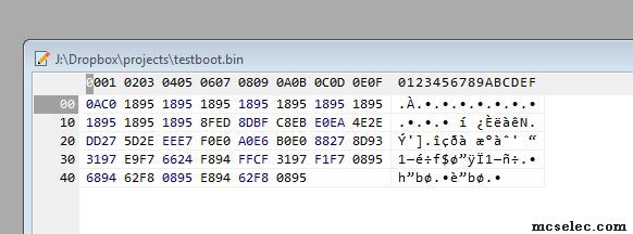

Here is my bootloader code, which is in a file called "testboot.bas". It has only one instruction:

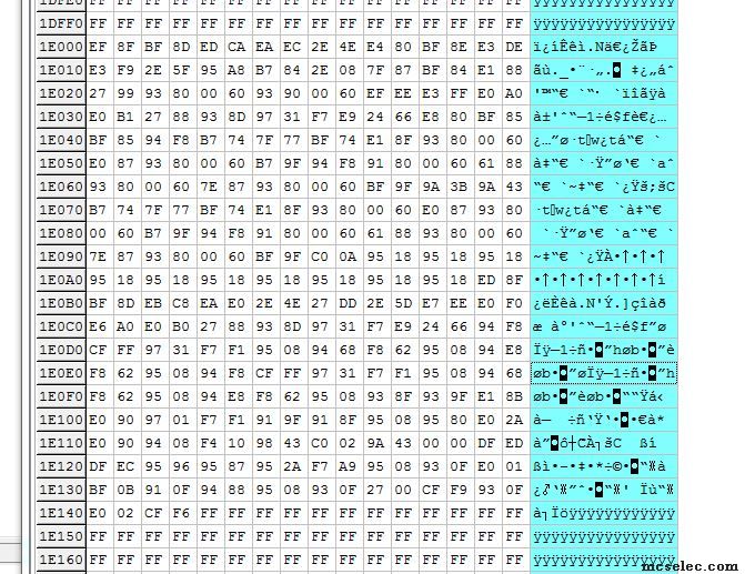

When I compile the testboot.bas the compiler generates this:

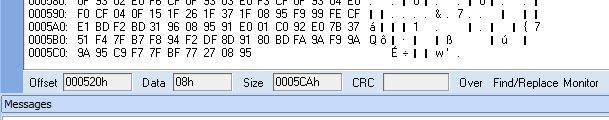

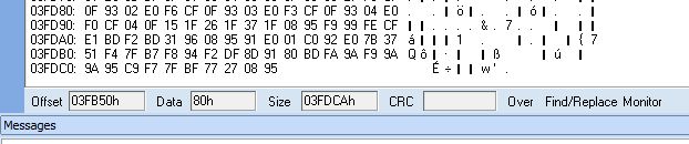

And here is what the ROM code looks like after I run LoadBL.bas:
As you can see, the insert starts at 1E000 which is correct, but the .bin file is inserted just after 1E090, but there is a whole lot of "stuff" in front of it.
The .bin file ends at 1E0D0 , foloowed by more 'stuff' that I dont know from where it came.
The remainder of the rom from 00000 to 001C0 has the code from LoadBL.bas in it as expected and the bootloader section from 001D0 to 1FFF0 is empty as I expected.

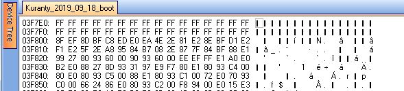

I think problem here is that you attach bootloader BEFORE "END" command so compiler will consider it like some code of main application and then AFTER END it will put rest of declared subs or core procedures for clearing SRAM etc...
I attach bootloader in the way you can look and then compare generated bin files. Everything looks perfectly fine. Bootloader is attached without any overhead. It starts and ends with exactly same values at the correct address 1FC00/2=F800
So move your attachment AFTER END command and then try

Ok, checked the results from your code, the reason for failure is that the compiler creates non-relocatable assembler code from the Bascom source.
Assembler code making use of RCALL, RJMP, relative branches a.s.o. is relocatable, you could shift it in address and it will still work.
Alas Bascom commands from the bootloader are translated partly into absolute asm-nemonics like CALL and JMP.
Creating the bootloader at &h0000 (done with $NOINIT) and shifting it is necessary, because otherwise you end up with the message: Flash used 187%.
Attaching all the empty flash via $INC at &hF000 will overrun the flash's border.
The reason is: the bin-file contains also all the empty space, it is simply a binary representation of the flash, it does not feature any address-directive.
As you use a special loader from SD-card https://www.mcselec.com/index2.php?option=com_forum&Itemid=59&page=viewtopic&t=12372 and this loader uses Bascom-commands, which again translate into non-relocatable code, the fun stops here for you.
The method would however work, if the bootloader is written in assembler-code containing only relative branches/jumps/calls.
One approach would take maximum a half hour, as it is not a big deal to write a small program with language, GUI and OS of your choice, which merges n-bytes of main-bin into the empty space of loader-bin, outputting a combined bin.
Another idea would be - in case the bootloader itelf is seldom altered - to create your loader regularly, then cut out manually &F000 * 2 bytes = 122880 bytes from start of the bin and save it as your loader.bin
By including this modified bin with the help of $BOOT and $INC at &hF000 you will get a working solution.
Using a hex-editor this is done in less than a minute. |
