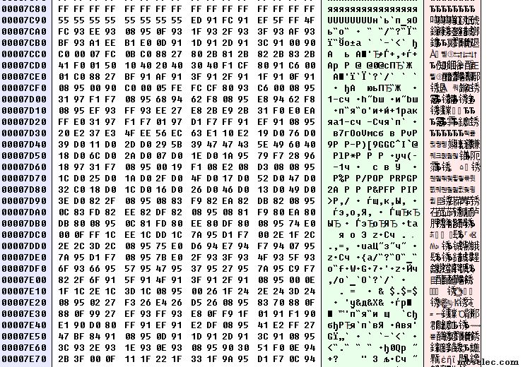

I'm trying to put the code at the end of the bootloader.
$asm
.org $3FC0 ' the last page
my_TEST:
.db $55 , $55 , $55 , $55 , $55 , $55 , $55 , $55
$end Asm
I get errors and the size is 101%

The code needs to be placed at the end of the atmega328pb memory, in the boot sector, after the existing bootloader. Problem in implementation (
$asm
.org $3E48
$end Asm
Where does the extra code come from?
