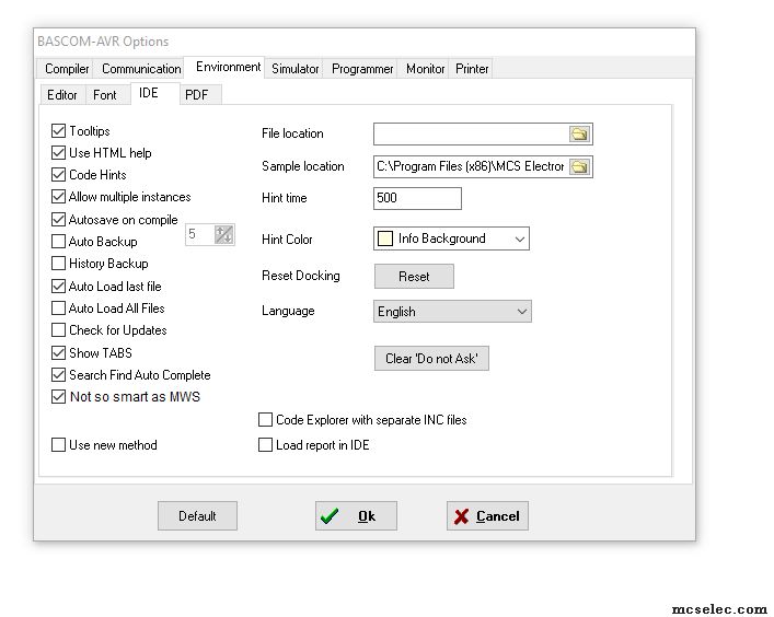

Hi edc
The compiler will give a warning about the hash but you have to set this checkbox first.
Wink
Now, Evert, how about you, do you have this checkbox checked?

PostPosted: Wed Aug 07, 2019 7:19 pm    Post subject: Reply with quote
As you can see in the screenshot I have it checked.
