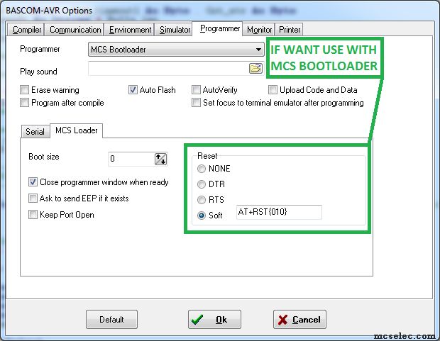

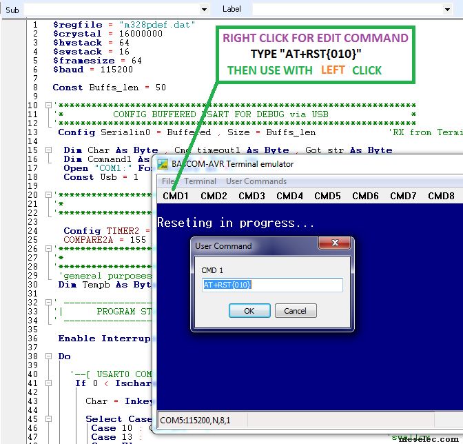

Here you have. Now you can add more "AT" commands but this basic code react for "AT+RST".
You can use it for debug/reseting over Bascom,or any other, terminal emulator , or even use it with MCS Bootloader.
Code: | $regfile = "m328pdef.dat"
