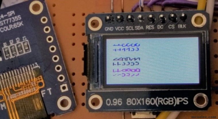

I'm using a O-Family ST7735S lib and I would like some help with fonts.
The color8x8.font work but I don't know how to create other fonts. I have tried font16x16.font and other fonts but they show as mixed up as seen in 16x16 pictured below.
My question is how do I create fonts for the ST7735S?

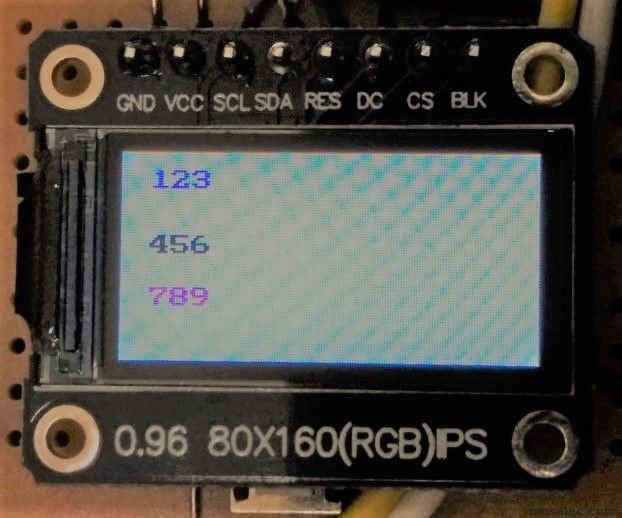

   '  *  0.96inch 65K full color LCD test  *
   '  *      160 x 80 dot [ST7735S] SPI    *
   '  *        O-Family  2021. 1. 5        *
$regfile = "m168def.dat"
$crystal = 8000000
$baud = 38400
$hwstack = 64
$swstack = 10
$framesize = 24
print version(3)
   '  * Initial setting of G-LCD *
$lib "glcd-ST7735S_160x80.lib"                              'Incorporate the ST7735S 160x80 library.
   'Designate the connection port of LCD. Cs1 = [CS] , A0 = [DC] , Rst = [RSE] , Si = [SDA] , Sclk = [SCL]
   'Config Graphlcd = Color , A0 = Portd.5 , Rst = Portd.6 , Si = Portd.4 , Sclk = Portd.7       '[Cs1] and [Rst] are optional.
Config Graphlcd = Color , A0 = Portd.5 , Cs1 = Portd.3, Rst = Portd.6 ,  Si = Portd.4 , Sclk = Portd.7
Const Portrait = 0         'LCD screen. (0: Landscape [X=160, Y=80], 1: Portrait [X=80, Y=160])
Const Rotate_180 = 1       'LCD screen 180 degree rotation. (0: connector Lower side, 1: connector Upper side)
Cls                        'Erase the entire screen of the G-LCD.
'For some reason, that I don't understand,
'my ST7735S colors are inverted.
Const White = &B0000_0000
Const Blue = &B1111_1100
Const Black = &B1111_1111
Const Magenta = &B0001_1100
'setfont Alpha_20p29x21
'setfont font16x16
Setfont Color8x8    'Only font that worked.
Lcdat 5 , 10 , "123" , blue , white
Lcdat 30 , 10 , "456" , Black , White
Lcdat 50 , 10 , "789" , Magenta , white
End
$include "color8x8.font"
'$include "font16x16.font"

Monochrome fonts and color fonts have different data alignments.
Please use [color16x16.font] in [Samples].
The post below has a converter that converts monochrome fonts to color fonts.
https://www.mcselec.com/index2.php?option=com_forum&Itemid=59&page=viewtopic&t=13094&highlight=color+colour+font+converter
