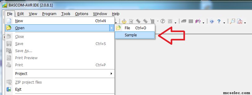

PostPosted: Wed Mar 13, 2019 6:34 am    Post subject: Reply with quote
where is the samples folder ? I have searched in vain !!
Neil
Tiny
Joined: 10 Nov 2010
Posts: 110
Location: The Netherlands
PostPosted: Wed Mar 13, 2019 6:41 am    Post subject: Reply with quote
in windows 7 they are in C:\Program Files (x86)\MCS Electronics\BASCOM-AVR\SAMPLES
Posts: 1136
PostPosted: Wed Mar 13, 2019 9:41 am    Post subject: Reply with quote
No need to search Very Happy
