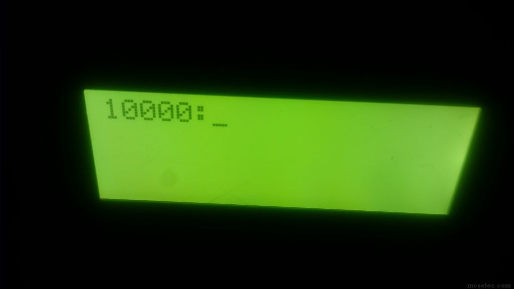

I had bought a new Laptop as I couldn't upgrade the Windows10 32 bit running on the bootcamp 4.0, The New laptop has by Default Windows10 Pro 64Bit. I did a clean install for all the software on the new machine. The Environment settings are exactly same on the New Laptop. I had put in my test code, here only for this code i reduced the $stack settings since Just a single variable is used, no subroutines, no interrupts etc.
As Suggested have increased the settings size, the ones i used in my actual program, attached the code here, still the same result, have attached the pic as displayed on the LCD for your kind reference.

Joined: 22 Aug 2009
Posts: 2335
PostPosted: Wed Dec 19, 2018 9:26 am    Post subject: Reply with quote
First, kick out:
Config LCDBus = 4
Neither you connect the display in bus-mode, nor does the ATMega32a provide such an external memory interface.
If the '10000:_' still shows after recompile, post the resulting hex-file for download and I will have a look through it.
Also try out what happens, if you alter lcd-output like that:
LCD Str(X); "   "
