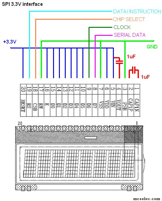

Please help me in the LCD interface SPI ST7036
I have never run LCD and ISP interface before.
http://www.artronic.com.pl/o_produkcie.php?id=2050?

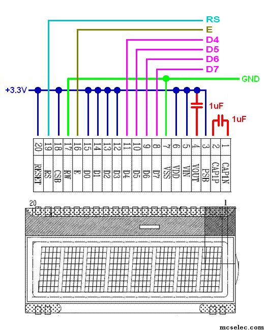

There are no library for HD44780-compatible SPI display. It can be written, but needs display in hand for testing.
You can connect this LCD with 4-bit connection:
 $regfile = "m168pdef.dat"
 $crystal = 16000000
 Config Lcdpin = Pin , E = PORTC.2 , Rs = PORTC.3, Db4 = PORTC.4 , Db5 = PORTC.5 , Db6 = PORTC.6 , Db7 = PORTC.7 ,
 Config Lcd = 16 * 1
 Initlcd
 Cursor Off
   Cls
   Lcd "TEST LCD"

are you using 3.3V For VCC ?
IF you use 5.0 you can buy another display....
JP Wink

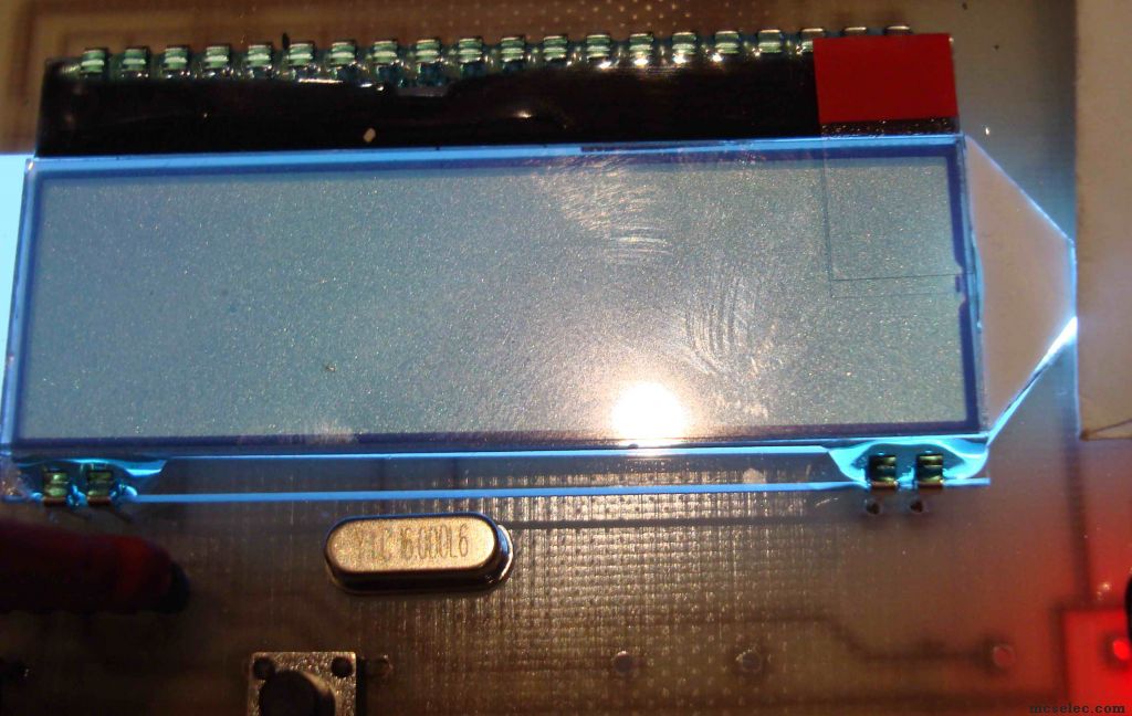

No reaction, nothing works,
I connected to 5v and 3.3v and nothing.
There must be some other initiation procedure
this display.

Sorry, CSB pin must be connected to GND.

There is still no reaction

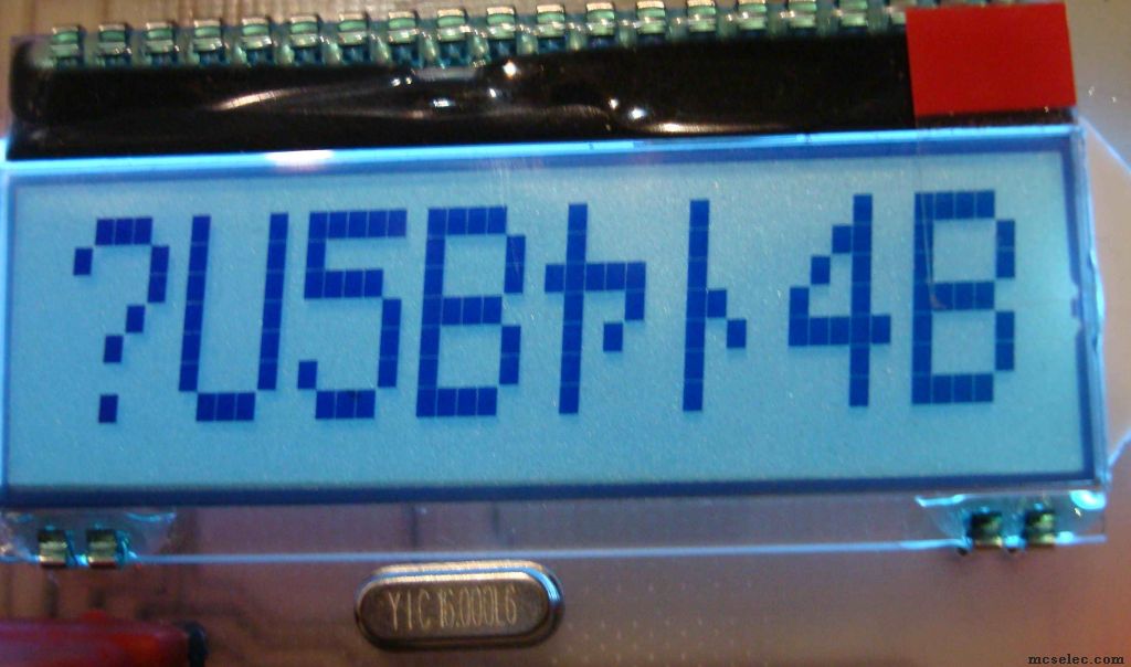

The display has started but displays nonsense.
$crystal = 16000000
$hwstack = 32
$swstack = 16
$framesize = 40
Config Lcdpin = Pin , Db4 = Portc.2 , Db5 = Portc.3 , Db6 = Portc.4 , Db7 = Portc.5 , E = Portc.1 , Rs = Portc.0
Config Lcd = 16 * 1 , Chipset = Dogm162v3
