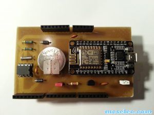

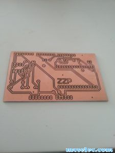

In the Dutch and German Elektor an article about UV lasering of photosensitive printed circuit boards. Edition of Jan/Feb 2017.

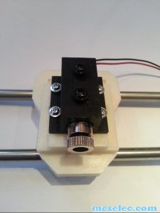

Instead of making a film and expose the printed circuit board with an UV lamp, a 500 mW laser is used.

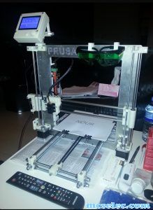

On this page, still in progress, some details about the Eagle to Laser Engraver converter. How to modify your Prusa I3 3D printer for laser engraving, and some real examples of finished boards.
http://pcblaser.benshobbycorner.nl
All source code will be published.
