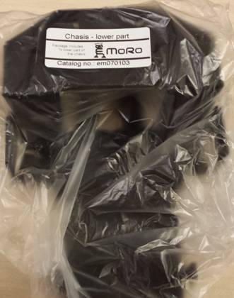

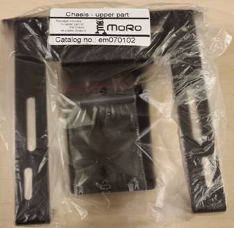

The KIT is shipped in a big box. This box is filled with all material.

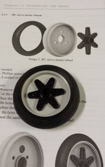

Enthusiast as I was I began constructing and prepared the wheels for a gearbox while my model uses direct servo drive.

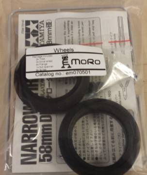

The wheels have good quality tires. In fact all of parts of the KIT are of high quality.

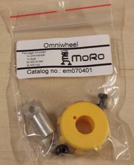

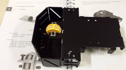

The Alka Knight has an omni wheel. Ballcaster and Twinmotor are optional.
After my mistake with the wheels I read everything more careful and I understood to read/skip specific parts in the manual. Like mentioned before, it is important to use the Drive Servos for the wheels.
Assembled frame with Omni-wheel.

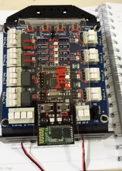

Almost done with assembling. As you can see the board is protected by a transparent shield.

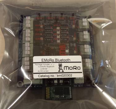

The processor board has a BT module , a reset and a generic button. The board also has a JTAG and ISP connector.
All hardware can be accessed with connectors so you do need to solder anything.

Before connecting the wires make sure the board power switch is OFF.

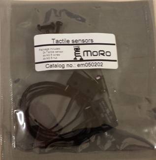

While all sensors used (LCD and switch) are not sensitive for polarity, the servo wires are!

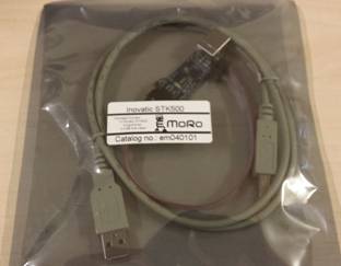

For autonomous operation you need the ISP programmer. An STK500 compatible programmer is included. Do notice that once you use the ISP programmer, the original firmware will be erased. That is not a real problem since can program the original firmware back in the controller when you need to.

The chassis is light weight and sturdy metal and you can mount the 2 Alka Knight servos on a different location too. The drive sensors can rotate continuous so these can only be used for driving. The other servos have a stop. These can be used to control levers.
