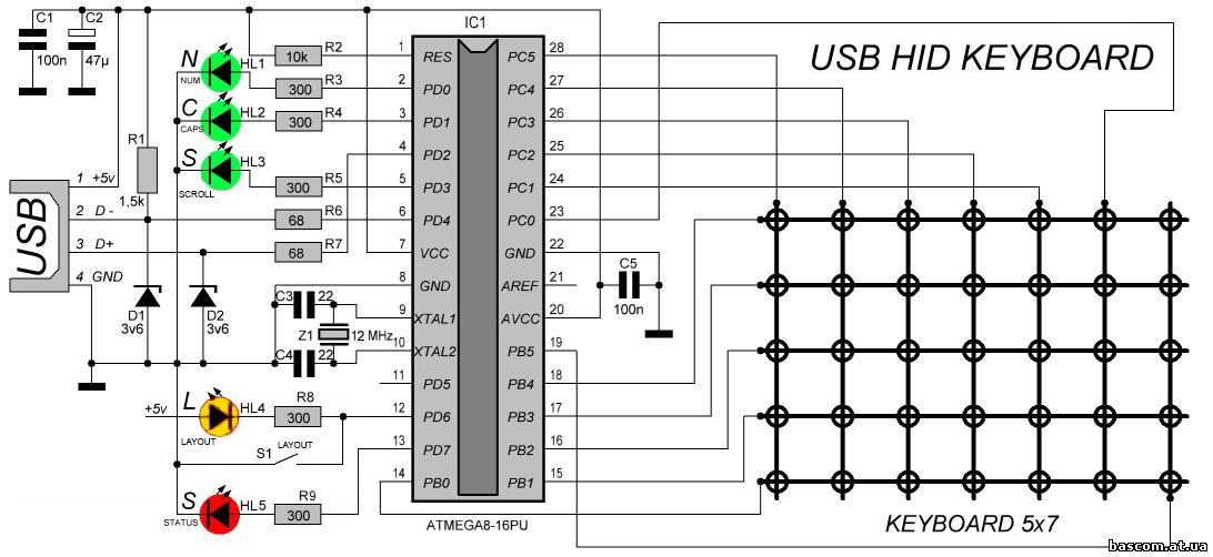

Schematic diagram:
  Program uses the software USB library, written by Mr.Ollopa. For contemporaneously working with keyboard and multimedia interfaces it use two USB-endpoints, so it enumerates by system as a combined device. It required some changes in HID descriptors and configuration. In program code this changes marked for better understanding. New added strings and variables with ***, changed from original - with !!!. Also (for better reading) descriptors, USB configuration and key combination were written as separate *.inc  files.
Keyboard matrix is 5x7, so it utilizes 35 keys (can be less or up to 49 using D5 & D6 port lines). In program keys represented with numbers from 1 to 35, corresponding combination is 3 bytes and has address in EEPROM as

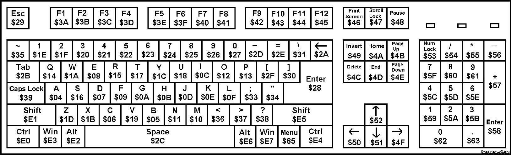

third byte is key number according to HID table (not compatible with ASCII !!!):

Data consist its letters in key numbers according to USB keyboard HID table (see below).

For utilize 70 keys simply add layout switch S1 (LED "L" will light then S1 is shorted):
In included BASCOM example keys stored in EEPROM for this schematic are (key 35 is for sending frase "BASCOM-AVR"):
