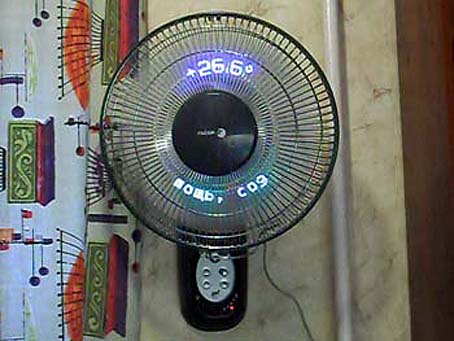

This device works like a Bob Blick’s LED 'propeller clock' . It has a Hall-Effect sensor and a magnet. Every time the magnet passes by the sensor, the sensor sends a pulse to a micro controller. The micro controller counts the time between pulses and uses that information to turn on the LEDs so that as the propeller rotates, the LEDs are always lit in the same location. Because the LEDs are really bright we see a streak when they move. Since they're moving really fast, the pattern of LEDs ends up looking like a persistent/enduring image. That’s why it’s called "persistence of vision", or POV for short.

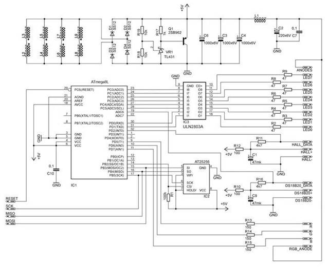

The micro controller is an AtMega8L running at 8MHz internal RC-oscillator (here there is no need for a quartz accuracy). For temperature measuring I used DS18B20 sensor with 0.50 accuracy and 1-wire connection. Scrolling text stored in the EEPROM AT25256 (works with hardware SPI of AtMega8L) and contains 32768 symbols (I place English-Russian dictionary with 1000 words and its translations). Program has an ASCII symbol table and text in AT25256 written in Window’s “notepad”. “Line feed” and “Carriage return” symbols replaces at “screen” with space symbols.
Text created with 8 dots. I use 16 Bright SMD LEDs 1.5x1.5mm, two LEDs in parallel for each dot. Viewing area contains 256 sectors. First sector begins at 450 from left horizontal position. Temperature indicates in upper quarter, scrolling text in lower quarter. In left quarter processor reads temperature from DS16B20 and wait for Hall-sensor interrupt. Timer0 works at 31250 Hz (8МГц/256) and measure turn time, timer1 works at 8МГц and creates a sectors length, so never mind of propeller’s speed displayed text is always stable. Timer0 is only 8-bit and may overflow up to 10 times over turn of propeller, so we register these overflows in “T0_slave” variable.

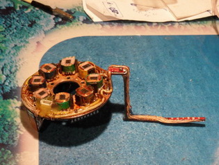

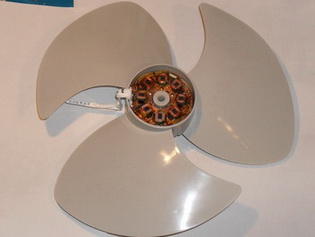

Power for schematic generates with 8 transformers, rotating with propeller under 8-pole magnet (from VCR head motor).  VR1 with Q1 works as power shunt regulator. This fan has 3 speeds and in lowest speed generating power is not enough for all, so we display only temperature. On second speed display temperature and scrolling text. On third speed we added ambient light – blue, red and green.

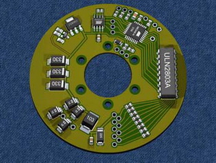

Plate is two-sided, but had no vias. It placed in back hall of impeller and fixed with 6 screws. 8-pole magnet mounts with glue on plastic female screw.
Schematic:
Placement:
Assembled plate:
Mounted on wheel:
