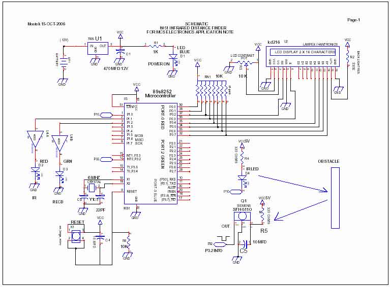

    Infrared proximity detectors are commonly used in robotic projects in sensing obstacles. If you need to measure the approximate distance from the object for wall following or maze solving robot projects, you need to use ultrasonic or reflective unmodulated light sensing circuits using expensive components. This circuit that can be used with ATMEL AT89c2051 to generate a 38k burst frequency of IR and receive it using Siemens SFH5110 receiver to calculate an approximate distance from the reflected object.
    This article uses AT89s8252 and an lcd for demonstration.  Int-0 multiple count generated during the IR 38k Burst is used to find out the distance with INT edge triggering turned OFF . On experimenting , we found the count vary from 0 to about 900 for an object  distance of 12” down to 3”. A comfortable variation in value to experiment with - in close proximity sensor projects.
    IR modulation is normally done using a 555 wired as a square wave oscillator. To reduce the number of components, the software generates the frequency through a port pin with the correct time delay between ON/OFF periods. With a 6 Mhz xtal, the time period is too short, so NOPs are used for the timing with two BYTE variable loops in the software that sends a burst of 38 Khz for a duration of about 1/0th of a second.
    The final count can be used in the project to find the approximate distance if the object . Two leds indicate the IR xmit in progress and IR recd.

Schematic below:
