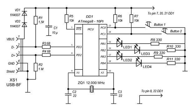

Demo - device
Demonstration device allows two-way exchange of arbitrary information with a computer.
The scheme is shown in Figure.
Scheme
The program has a fairly large size (almost 1000 lines), so will be considered only fragments responsible for the configuration of the USB driver and the exchange of information. In the original program was replaced by the HID device descriptor, such as the joystick, to handle non-standard HID device, which allows exchange of arbitrary information. There was also activated by the second endpoint and is configured to receive information from your computer. This tag defines the type of HID devices. Depends on him, whether the device, keyboard, mouse, joystick, etc. In this demonstration device, HID descriptor has the form

In the first line, given a number of bytes in the descriptor.
The second and third line describes the type of device. In our case, this non-standard HID device.
Next is a description of input and output endpoints.
Options Logical_minimum and Logical_maximum determine allowable range of values stored in the buffer of the endpoint.
Parameter Report_count determines the number of bytes transmitted or received for one parcel. The allowable value of 1 ... 8. In a demonstration device, is transmitted and received, only one byte per parcel

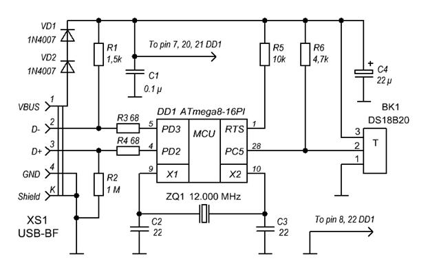

USB thermometer
USB thermometer is based on a package of demonstration device. Major changes were made in the main program loop.

From the main loop removed code that takes data from the computer and added code, the survey sensor DS18B20. The data from the sensor to read no more than once per 750 milliseconds. In order not to delay the work of the main loop for a relatively long period of time, we used variable Flaginputtermo as flag. In interrupts of the timer Timer1, occurring approximately once per second, the variable is written the number 1, which is a sign of the need to read data from the sensor. Upon completion of reading, the data is copied from the array 1wire_array in array _usb_tx_buffer2 and call the function Usb_send, transmitting data (2 bytes) by bus USB to a computer.
In the HID report was a small change (highlighted in green color) associated with the need to transfer 2 bytes for sending.
